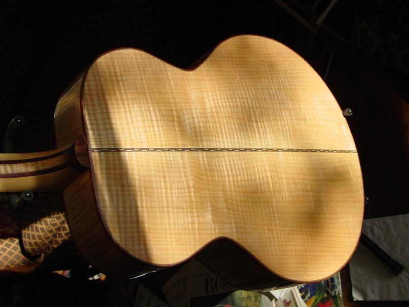

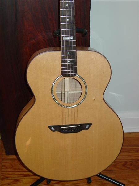

Hey all,
I've been reading this forum for a few months now and I'm almost finished with my first guitar - a J200 style jumbo. It's always interesting to see pictures of other's work so I thought I'd return the favor. I still need to finish the neck and make a trussrod cover.. playing it and starting my 2nd guitar has gotten in the way of that :) Hope you enjoy.
-Karl
Oh, Here are the specs:
top: sitka
back/sides: curly maple
bracing: red spruce
bindings/headplate/endgraft: koa
rosette: paua abalone
neck: maple/granadillo/curly maple
fretboard and bridge: macassar ebony
finish: KTM-9

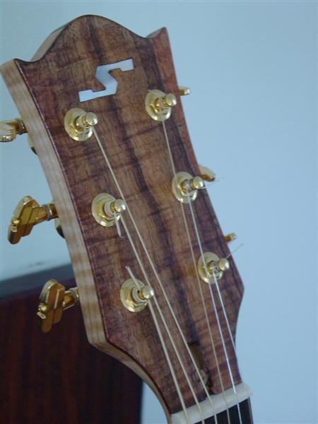

Beautiful work!! I also like your bridge design and headstock.

Your sound hole looks to be a little undersized .Particularly for this big instrument.If your bass becomes too dominent , I'd look at enlarging the hole to raise the box frequency.Even an extra 1/16 " diameter equates to a substantial increase in soundhole area. You must be a big fella to be able to hold on to this one ! What's the reasoning with the very upper bout braces ? ?

Thanks for the advice. Actually I used the J200 plans from LMI, so the soundhole and bracing are basically the same as what's on the plans. Maybe I'll try enlarging the soundhole on the next one I build.
